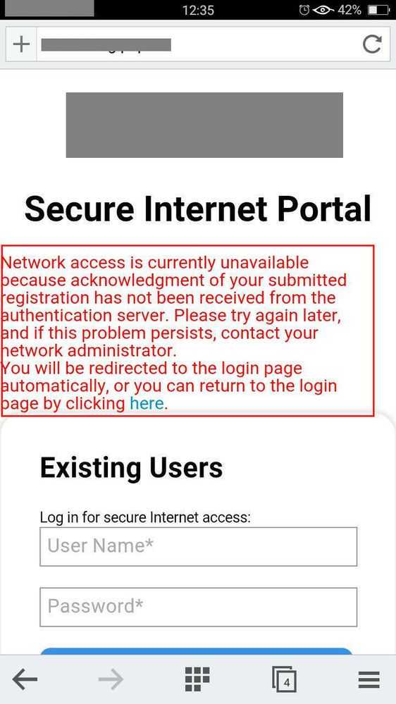

Hi, Please advise me about Hivemanager NG Onprem.It’ve error occured message as picture below.
Procedures.
1.Guest connected CWP1-SSID is success and after that can be getting DHCP IP addresses.[OK]
2.Rediect to the registered form and registered its successfully [OK]
3.Guest ‘ve received information for account login.[OK]
4.Guest were getting start fulfill his username and password in CWP but it had display errors.[FAILURE]
Thank you for your support me.

I’d recommend enabling some auth debugs so we can get more details on why the authentication is failing after they register successfully. This guide covers how to enable auth debugs (please note the bit about disabling auth_info, those logs clutter up the buffered log and make things harder to read). If you can enable auth debugs, replicate the issue, pull tech data, and send the tech data and the MAC address of the client device you used to replicate the issue to me at community@extremenetworks.com, I can take a look and let you know what I find. Alternatively, if you have current support with us, you could always open a case and attach the tech data file to the case to review with one of our engineers as well.

i saw user DB normally after registerd successful? any idea?
SamPirok
Community Manager
You may want to open a support ticket for this so we can review your configuration over a call with you. If you don’t have support, could you tell me if you’re seeing those users in your user database after they’ve registered?
