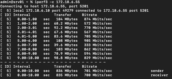

I am doing some testing with iPerf3 and i am surprised about the results I'm seeing.

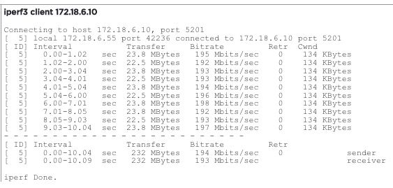

If I test with Gigabit cabling, from Host to AP I get good results the other way around it looks less great (see Screenshots).
Whats the explanation for this beaviour? If i test AP to AP the results are simular low ~200 Mbps

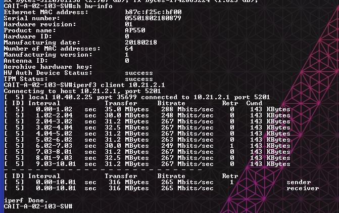

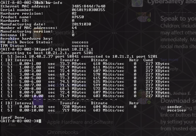

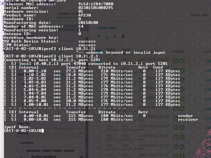

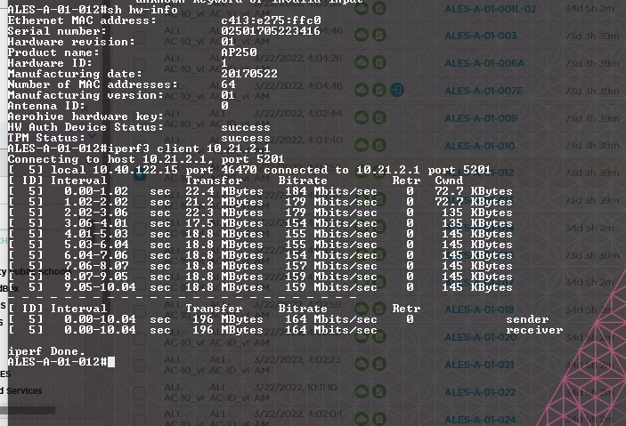

@a.huerzeler, any news? I just did some iperf3 testing from several of my access points, and I'm seeing mixed results. Curious what is going on here.
@Sam Pirok any idea why I would be seeing such low throughput on the 550,250,&230, but not on the 650? These are all Cat6a cabling patched into HP/Aruba gigabit switches.
