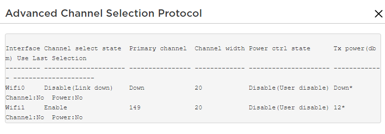

But if i select the AP and then go to Utilities >» Status » Advanced Channel Selection, it is showing wifi0 as disabled - link down, shown here:
So if wifi0 Up or down? Why is that showing wifi0 as Disabled (Link Down), and yet clicking on an AP, shows devices on both wifi interfaces?

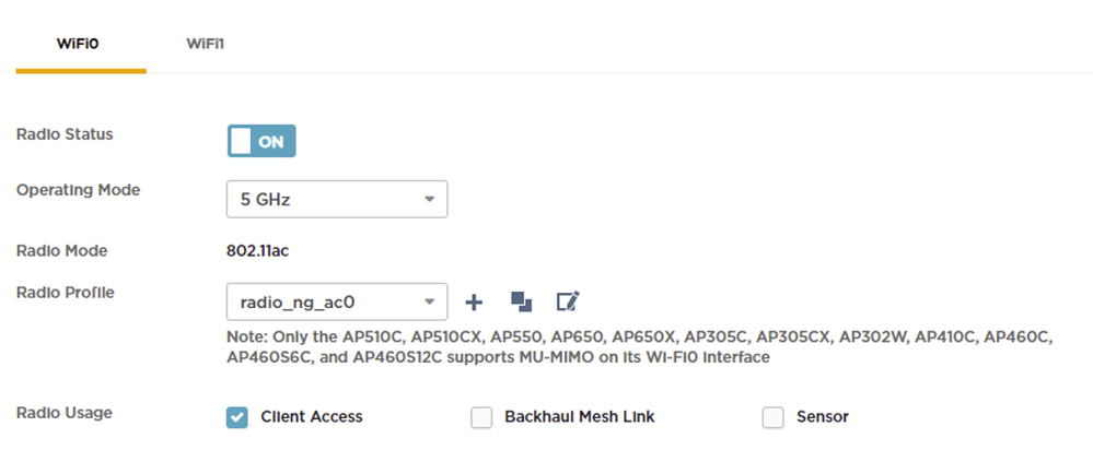

We disabled 2.4ghz on the AP650 Template, and replaced it with 5ghz, this is what it looks like:

I got back to my office, logged into XIQ, selected that AP, and did Status » Advances Channel Selection. Its still showing Disabled:
While the AP did reboot, it did it prior to that change on the Switch. So im rebooting the AP now, and will see what it shows in Advanced Channel Selection.
When we took it off 2.4ghz, and selected 5ghz for wifi0 interface, it auto-selected the radio profile. I’m wondering if i should change that and see what happens. This is what wifi0 looks like:

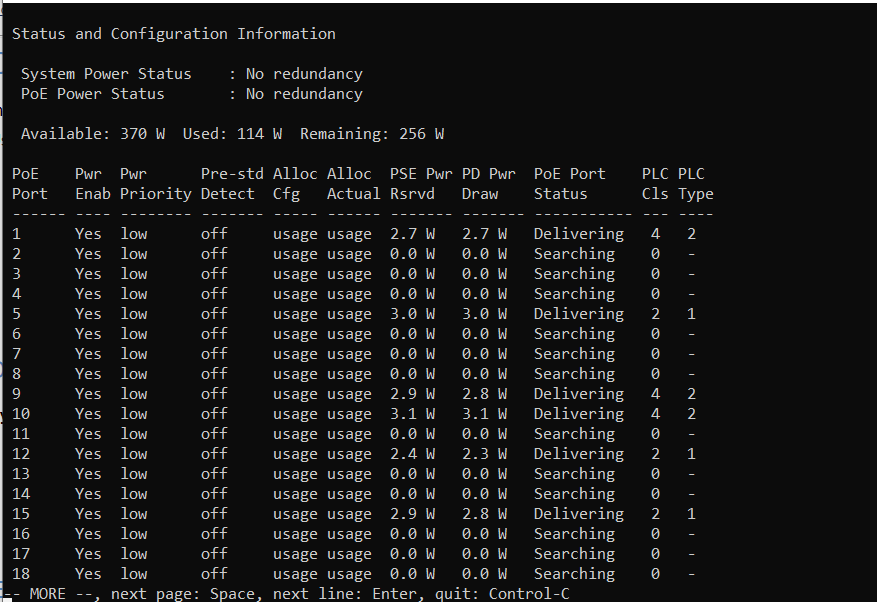

We have two types of switches, HP J9729A 2920-48G-POE+ switches and Aruba JL557A 2930F-48G-740W-PoE+ - 4SFP Switches.
I telnetted into one of the 2920’s - which shows its POE+ at the top - and used the show power-over-ethernet brief, and as you can see form the screen grab below, we are way under the 370W max:
Those 2.7, 3, are VoIP phones, the AP’s are drawing about 10-12W’s, shown here:
I do not believe other than the banner at the top stating its PoE+, and spec sheet, that there is a way to see if its delivering PoE or PoE+ power. I don't think there is such a thing, it is just what it is, PoE+
