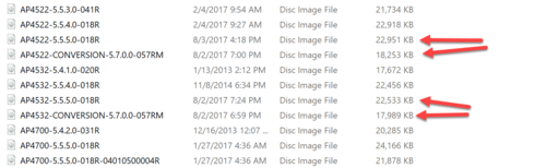

Chris, thanks for this info. I updated each directly from it's own UI (not from a controller). The image looks to be about 3mb smaller than the older ones (5.5 for example). I checked the download pages, but for these older AP's, I only see this one image available. Are full images available somewhere else? Again, these are 4532 and 4522 AP's. I've attached a screenshot of the sizes of each from my tftp folder.
65fd42a2f401430e9712073c75bcfda5_RackMultipart20170804-110507-187qx3f-2017-08-04_8-34-37_inline.png
