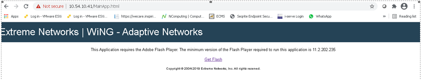

We have Ap310i , only can able to access CLI and not able to access GUI mode so please suggest on this .
Current firmware version 7.4.1

Oh, that one… So the problem is Flash being EoL. You have three options for this:
Hope that helps,
Tomasz

As of now we can access web console with WING MAN.
Thanks for your suggestion.

04-08-2021 10:09 AM
The above error message is getting while try to access with GUI mode..
04-08-2021 08:13 AM
What kind of behavior you get when attempting the GUI? 403? 404?
To double check, was the AP upgraded thru the wireless controller? If so, you will see 404 as controllers consist of “LEAN” AP images ie. without GUI. You’d have to upload a full AP image from the partner portal and upgrade with that one (or upgrade the AP directly) to keep the GUI available.
If it’s 403, I’d take a look at management policy.
Hope that helps,
Tomasz
