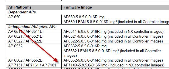

Does anyone know the latest or last wing software version that would still support AP 7181 ?

From the v5.8.5.0-016R release notes:

Christopher_Fra
ckelly
I don't have the 5.8.5.1 Release Notes locally, but I would trust that THIS is the correct answer.
ckelly
Odd Ron...my version of the Release Notes does not have that entry.
Here's mine:
Christopher_Fra
Service release v5.8.5.1-003R is the last release for the EOSL AP7181.
