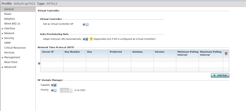

I have an issue concerning dynamic virtual controller. I have 3 devices of AP-7612 model (wing version is similar on all devices: 7.3).
According to
https://extremeportal.force.com/ExtrArticleDetail?an=000080546
I want to implement this feature.  Unfortunately, I don’t have Auto Election option on GUI. Although I have found that this device is running enterprise UI only that should allow do this.
Thus, what’s wrong?

What concerning to CLI, I have the following entered:
enable
config terminal
profile ap7612 default-ap7612
virtual-controller ?
<cr>
Means that device missed configuration about virtual-controller.
As I know, if I enter just “virtual-controller” command - my device will be set as virtual controller. It’s similar option to GUI interface “Set as a virtual controller”
