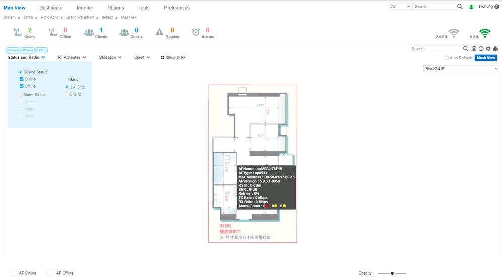

KeN_Chung
I uploaded a floorplan to Nsight and placed two APs on the floor plan, but I cannot see the AP icon. I realized the APs already on the floor plan, but no visial color shown on the AP. Any idea?

Daren_E
Just confirmed I am seeing the same thing on that code.
Seems to be fine on 5.9.2.x code.
I'll submit a problem report to engineering.

KeN_Chung
Daren, thanks. I found all tools cannot be conducted normally. Some tools do not show the result on GUI. Can you also comfirm GUI bugs?
Daren_E
KeN_Chung
The version is 5.9.3.0-007R. Thanks
Daren_E
Hi Ken,
Can you confirm what version of code Nsight is running,
This looks like a GUI bug to me.
