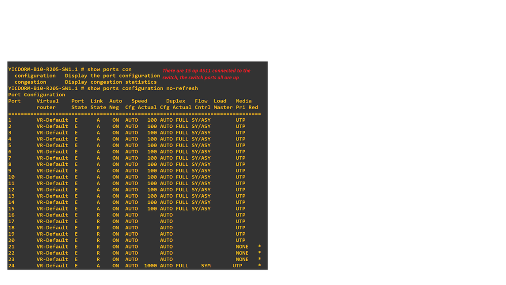

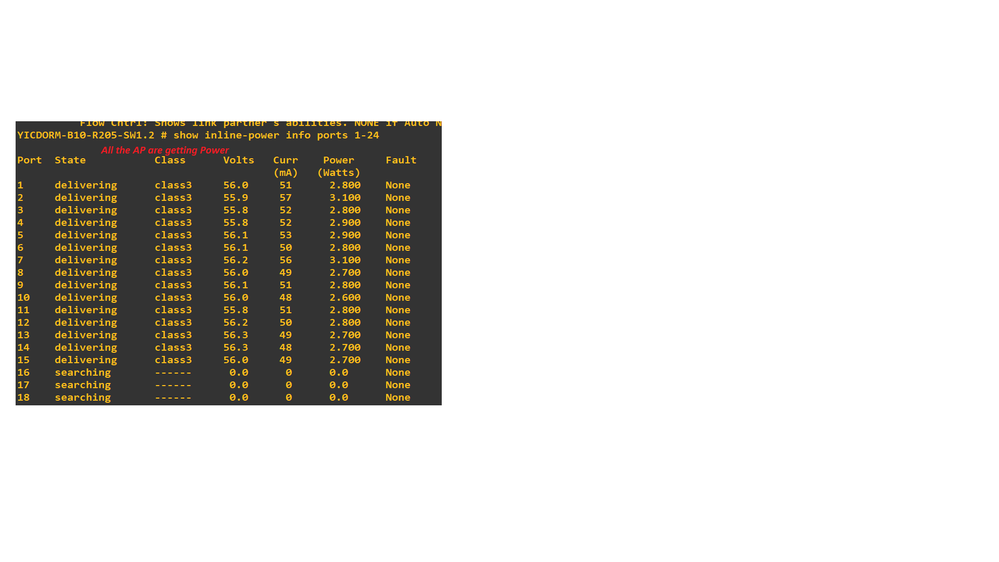

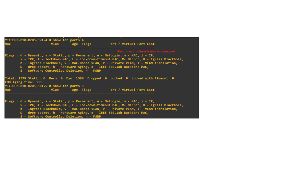

We have some extreme AP4511 that seems to be not working properly and both led are solid,
Although when the AP is connected to a PoE switch, the switch port is up.
