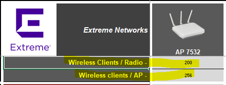

Christoph_S
Hello Aviv,
You can have up to 200 wireless clients per radio and a max of 256 per AP:
I hope this helps,
Chris
