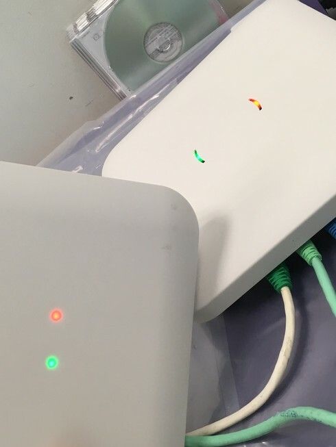

a77a3625fdf54429a2295b79429a39fe_RackMultipart20180410-75875-inapq1-IMG_4687_inline.jpg

I don't have the AP8432, but tested the following on the AP7612
ap7612-3B376E(config-profile-default-ap7612)#service power-config 3af-out
ap7612-3B376E(config-profile-default-ap7612)#com w
the power then come up
sorry for the delay
needed to find the AP
