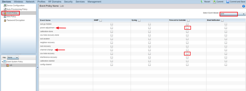

Hi Victor,
The alarm events you are looking for are available under “Smart-RF” events. Please see below:
You can also refer to the following article for more details around how to configure and apply the event system policy to the controller:
https://extremeportal.force.com/ExtrArticleDetail?an=000090652&q=WiNG%20event%20system%20policy

Hi Victor,
