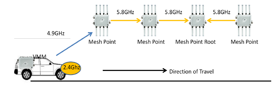

One of customer having roadway, that distance is around 2km. one lorry travel from A-B, & B-A for around 50 -70km speed. in that inside lorry their used one web application. for that we need to provide hotspot. so here which solution we will give. kindly suggest. please find the roadway attachment.
based on diagram we need the wireless signal for that rounded area.

Hi Saravana,
You can use ExtremeWireless WiNG MeshConnex to achieve high-speed wireless connectivity. You will have a Root AP (Root AP is an AP that connects to a wired network) on the building and a few Root APs along the road, for each Root AP you can have up to 4 Non-Root APs (Non-Root APs only connect to power and communicate wirelessly with Root APs), this way you can provide coverage to the entire stretch of the road. On the Vehicle, you will have an AP also known as VMM (Vehicle Mounted Modem), VMM will communicate wirelessly with Root or Non-Roots APs whichever it is closer to while driving around. VMM has two radios, one radio will connect to the Mesh (Root/Non-Root) and the second radio will provide the hotspot. You can use AP7562, AP7662 etc. for this purpose. Following is the illustration of a similar setup with Root, Non-Root and VMM:
Regards,
Ovais
