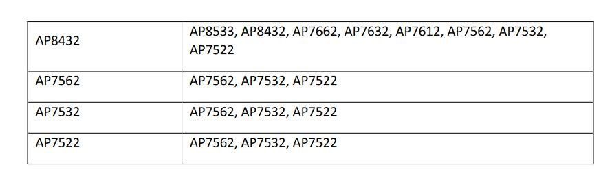

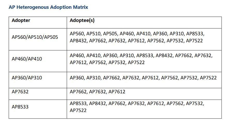

In VC mode the limit is 64 APs. Since the VC mode supports heterogenous APs, you can set AP410i as a VC and manage your AP410i/310i with it but not the other way around. Here is a little VC Adoption matrix for your better understanding:
