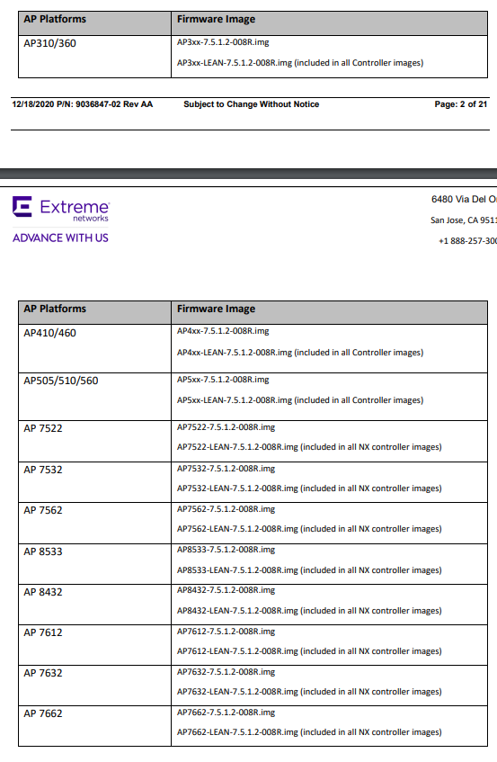

We are running NX5500 controllers in a cluster and just found out that WIFI AP7532s are discounted we need to know which newer cost effective indoor model WIFI APs can be added to our controllers and co-exist with the AP7532s in our environment and what specific version of the new Wing 7 firmware will support both ?

I’d recommend trying with AP 310. Seems to be the latest hardware, working with WiNG 7, 2x2 MIMO which is enough.

below a screenshot of the v7.5.1.2 release notes > platform supported section.
The AP7532 is listed so I’d assume you'd choose any other AP in that list and it will work.
