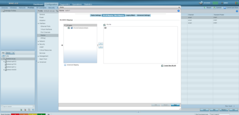

From the GUI click on:
"Profiles"
Then Click on:
Then Click on:
Radios:
Then open each Radio and under 'WLAN Mapping /Mesg Mapping' tab add the required SSID to Radio 1 and Radio 2
Exit
Commit and Save
