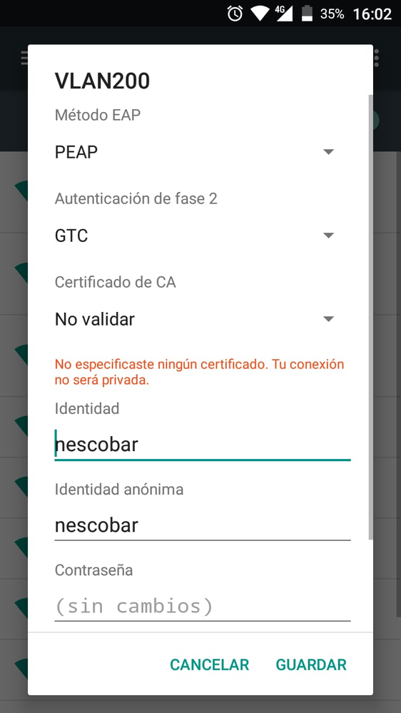

I understand that it is due to bad EAP configuration in the wireless client but I already defined it to be PEAP-GTC and it is not working for me
this is my wireles client configuration
03-06-2020 04:36 PM
Have you configured the wireless client supplicant correctly?
What EAP method is the wireless client using?
I assume PEAP/MSCHAPv2 based on user/password. If using certificate, the RFS would need to be staged as such. If no certificate is being used, ensure that “no validate server cert” on wireless client supplicant is checked.

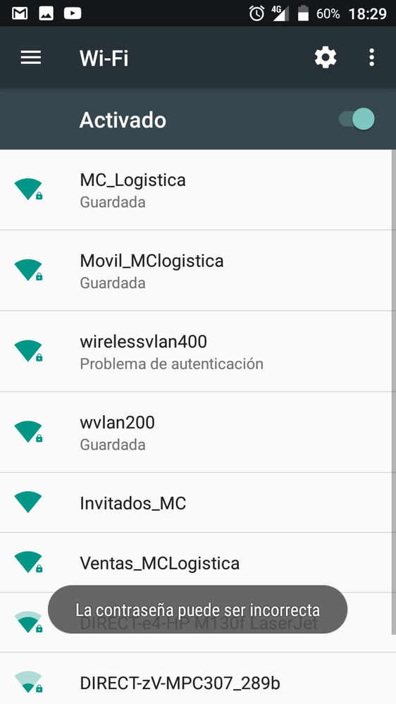

03-06-2020 12:32 AM
I try your comment, this is the controller configuration
rfs4000 B4-C7-99-FB-82-ED
use profile default-rfs4000
use rf-domain TEST
hostname rfs4000-FB82ED
license AP DEFAULT-6AP-LICENSE
license ADSEC DEFAULT-ADV-SEC-LICENSE
ip domain-name 8.8.4.4
ip default-gateway 192.168.200.1
use radius-server-policy FabrilPolicy
interface up1
switchport mode trunk
switchport trunk allowed vlan 1,200,400
switchport trunk native vlan 1
interface ge3
switchport mode access
switchport access vlan 200
interface vlan1
ip address dhcp
ip address 192.168.0.1/24 secondary
no ip dhcp client request options all
interface vlan200
ip address 192.168.200.50/24
interface vlan400
ip address 192.168.4.50/24
use dhcp-server-policy TEST-DHCP
This message send me when I try to connect the wireless vlan400
