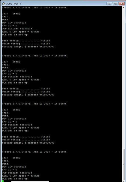

‎05-29-2017 04:16 AM
This is the sequence. I cant stop it or get in to cmd mode.
Tamizharasan,
this is actually expected message (at least what you show on screenshot).
Could you give me the whole output from console with the looping sequence?
Regards,
Ondrej
Regards,
Ondrej
