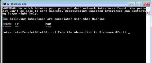

Got this error when I run the tool. what does it mean?

Thanks for the Info.
I have connected the AP via serial cable, but still the same msg as i mentioned above.
I have installed the tool and tried connect from the same subnet PC but still it didn't recognise.
is there any other way to hard reset the AP?
Thanks
Thanks

If you don't have a computer with serial port or another USB/Serial adaptor then you might want to consider resetting the AP using our Discovery/Reset tool.
Instructions included.
Thank you,
Chris
Thank you,
Chris
