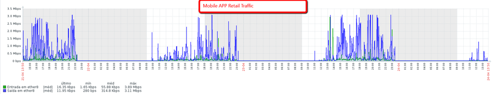

See below, my traffic in WLAN for retail APP is minimum (in Guest network we have 3x or more traffic w/ high density).

Yes. Average band per device. SAP uses low BW but require low latency. QoS is primordial in enterprise WLAN.
