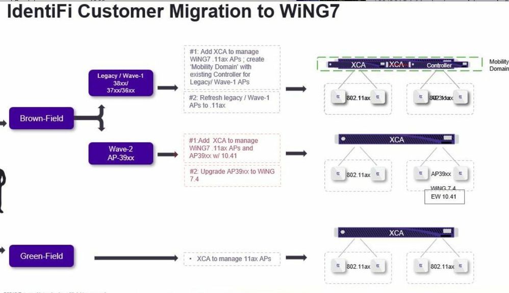

Hello,
can someone describe how to migrate identifi 3935 ap to wing managed by XCA ?
What are limitations, what about existing Licences ? Requirements ?
regards,
Tomek

PeterK
Contributor III
from technical view:
  • configure all you need on XCA
  • modify your discovery configuration (maybe change dns record from identifi to xca)
  • set AP in identifi to pending
now the AP should join to XCA.
This is the current way.
For flashing AP39XX to Wing 7.4 I can’t give you information. AFAIK it’s not available yet.
But when it is available, the XCA should have a image or process for flashing these APs. All other will be a nightmare.
Extreme Sales are able start a migration process for AP-CAPWAP Licenses.
Limitations? This depends, what you’ve configured in identifi.
