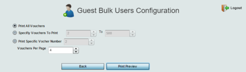

Using the bulk user creating on web admin I was able to create ~8200 users (didn't test more) and I am able to print up to 4 vouchers per page (WiNG 5.9)
See below:

Regarding the voucher size - this is supposed to be printed using mobile printers. There is unfortunately not much you can change on WiNG side.
More options are under Printer preferences
