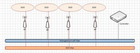

Hi Rick,
first of all I think tha could be better to put all APs and Controllers in the same Vlan, across the campus, untagged it on the switch port where are connect each AP, this permit to have a management Wifi Vlan, and use a DHCP server to distribute IP Addres for APs.
After that you can create a single Vlan for each SSID across the campus and configure a bridge AP topology for this Vlan, in this way when an enduser roams, he maintains the same IP Address across the campus. This resolve application problems.
I hope this could help you.
