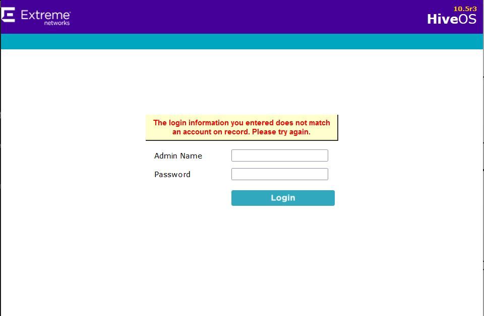

I have installed the new VX9000 demo version 7.9.0.0 for testing. I noticed that there are problems with the DHCP in this version. With identical configuration as the previous version, the new VX gets no IP address. I have first solved the problem with a static address.
NOVA is now activated by default. But the page is no longer accessible via port 10443. Without specifying a port, an "Extreme HiveOS" page appears, where you can not log in with the credentials of the superuser (see picture). Since I haven't found any documentation for 7.9.0.0 yet, I would like to know what I'm doing wrong? Or is the version simply buggy? Any ideas?

I have installed the regular version again. It works perfectly. It seems that the demo version is buggy.
