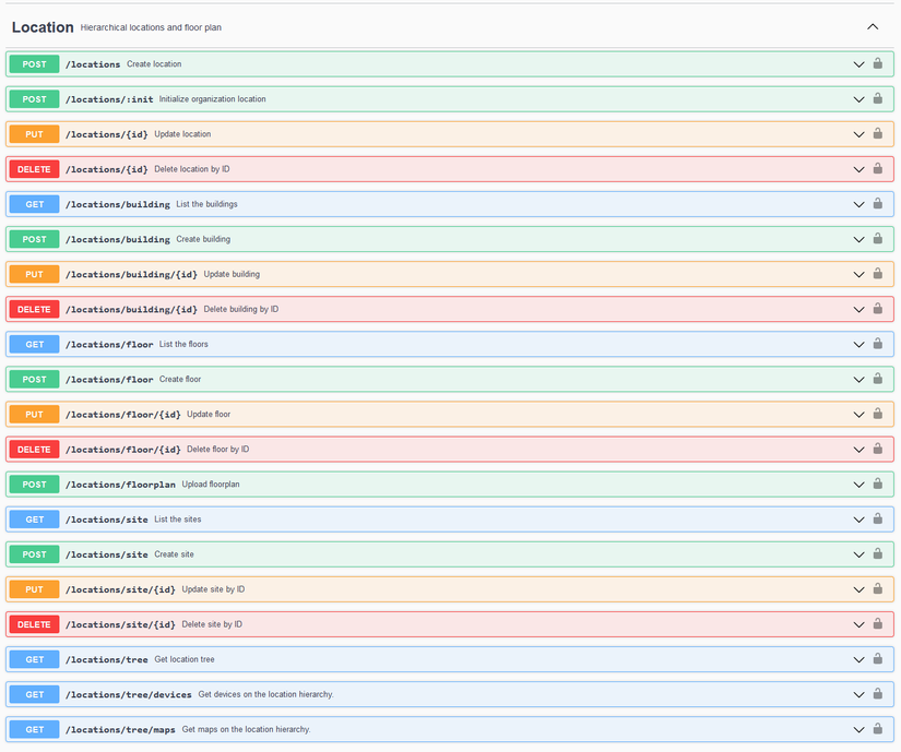

Current XAPI Location Endpoints

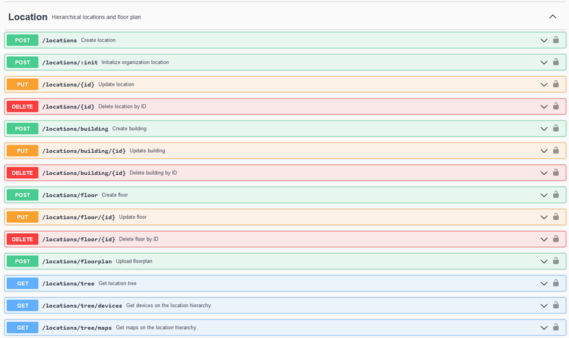

New Changes to Location End Points
