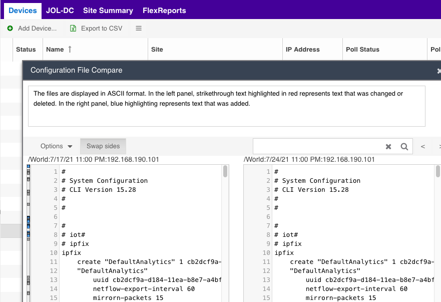

Why don’t you do the backup directly with the archive function of the XMC?
With this you get the compare feature

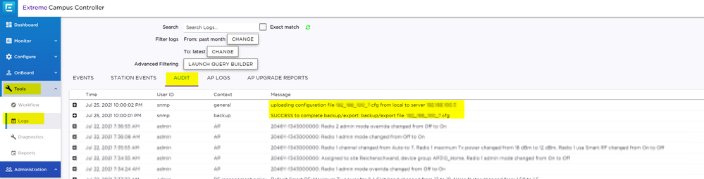

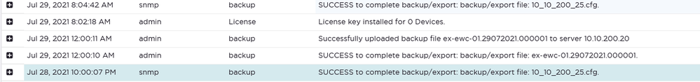

you can see the two backups here the timed job and then when it tries from XMC at 8:04. It looks to create the file. Then in the event log it seems to fail to SCP the file to XMC

It is important to check the audit log on the XCC!
If the backup work you can that entries:
