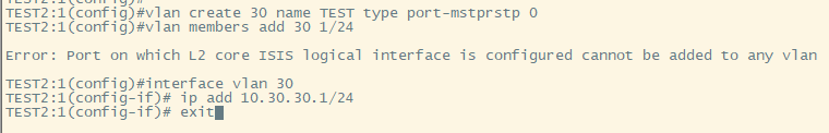

‎05-25-2021 06:59 PM
Well, looks like it won’t work. At least I know and can plan accordingly!
‎05-25-2021 02:12 PM
bfaltys,
I don’t think so but I can’t confirm.
I’m pretty sure you can add this to an existing dot1q interface without any issue.
You can easily test it on an unused interface. Tagg it and add a logical interface
Mig
‎05-25-2021 02:09 PM
If I add this to use a physical port that is already operating as an 802.1q trunk will it break the trunking? If it will I will have to configure a new interface and then move the link to the new one once everything is ready.
