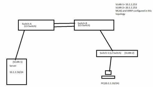

I need people from VLAN2 to access only one server on VLAN1, not all resources.
‎01-22-2018 06:22 AM
I need people from VLAN2 to access only one server on VLAN1, not all resources, just one single server IP. Basically, I want to keep both networks isolated except for that server that should common to both.
6 REPLIES 6
‎01-23-2018 03:21 AM
I want to keep both networks (VLAN-1 and VLAN-2) isolated except for that server that should access via clients of VLAN-2 and other devices are not even accessible and pinging. now help to create ACL.

‎01-22-2018 11:48 AM
This is an example :
BD-Lab.4 # show policy MS-VLAN-BRIDGE.pol
Policies at Policy Server:
Policy: MS-VLAN-BRIDGE
entry BRIDGE-TO-MS {
if match all {
source-address 10.32.32.0/23 ;
destination-address 10.32.0.0/21 ;
then {
permit ;
entry BRIDGE-to-BRIDGE {
if match all {
destination-address 10.32.32.0/23 ;
then {
permit ;
You hav to create a policy first, then add to an ACL :
configure access-list MS-VLAN-BRIDGE vlan "Vlan-100" ingress
if match all {
then {
permit ;
if match all {
then {
permit ;
‎01-22-2018 08:19 AM
is that a layer 2 vlan or layer 3? which device has ip adress on that network segment?
you should make a rule on that device, allowing/denying your traffic.
sometimes it is also possible to give that specific server a nic/ip from VLAN 2 - so you don't need to make exception rules.
it is up to you!
it is up to you!
