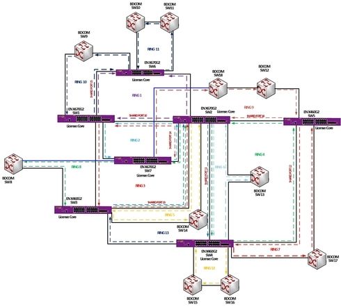

Hi, I need some help with EAPS rings design. My network is working now as the next image shows.

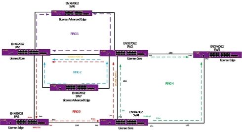

I have designed other rings and I have divided Original ring 3 into ring 3 and ring 13, changing some Licenses of course. I showed this design int the last picture.
I havent found exact information about limitation of EAPS, I remember that I received a training and the teacher told us of a specific topology that EAPS cant work in, I dont remember how it was, so I want to ask you about the possibility of implementing the topology I am planning, , especially RING 8 and RING 9, If not possible I cant ask to change the liks to connect to another switch. All the switchs are located in different places.

There are a couple of rules that apply and what we need to know is where you place the "master secondary ports" for all the separate rings.
The main blocking issue is the fact that there can be up to two shared ports per switch.
In switch SW-2, I count 5 shared ports.
http://documentation.extremenetworks.com/exos/exos_21_1/eaps/r_eaps-shared-port-configuration-rules....
The following page will show you the allowed topology possibilities:
http://documentation.extremenetworks.com/exos/EXOS_21_1/EAPS/c_additional-common-link-topology-examp...
I hope that this will help you a bit in the right direction.

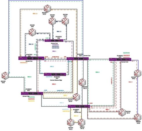

Ron, yes that brown dotted line shouldnt be there, I correct that and I add a new ring. I show the picture under this lines.
ada2b2bf9b684868ad1dd6d04942a1b3_RackMultipart20161101-129384-1bw9y9c-EAPS_Planned_v2_inline.jpg
Hi Henrique only ring 13 and Ring 9 are for particular clients , so if it's necessary and possible I would use protecteds vlan among all the other rings.
