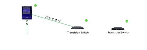

						Is it possible to have OneView build links between non Extreme devices? I have a bunch of Transition Networks switches in my network and I would like to populate the links between them. OneView builds the link from the Extreme switch to the first Transition switch but won't build the links after that.

						The Transitions switches really offer nothing in configuration of LLDP. I have two models of the Transitions and one only allows you to enable or disable LLDP and shows no neighbor information at all. These will not even make the link to the Extreme switch.
The other Transitions switch shows the neighbors and allows you to enable or disable LLDP but this one will create the link to the Extreme switch.
