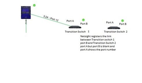

Upon further looking I have discovered under Network Details>Links it shows the links between devices. It registers the A port whether it is a Transition or Extreme switch but it will not register the B port on the Transition switches, it's just blank. Hope this helps.
![eaa222654ff74853b39b953553ec6bd3_RackMultipart20151211-11929-7phhgd-Transition_inline.jpg eaa222654ff74853b39b953553ec6bd3_RackMultipart20151211-11929-7phhgd-Transition_inline.jpg](/t5/image/serverpage/image-id/5743iD4131E87CF6F97BE/image-size/large?v=v2&px=999)
How can it register port A on Switch 2 but not register port B on Switch 1? It shows in the Link Details they are connected but Switch 1 doesn't show the port B #.
