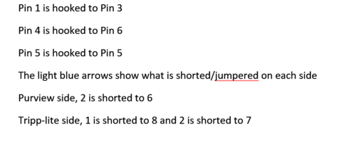

We are trying to hook a purview sensor PV-fc-180 to our tripp-lite serial console switch.
We have 9600, 8, none, 1 and no flow control for the settings.
We have a straight thru RJ45 cable from the console port in the purview sensor to our console switch. We also tried 9600, 8, none, 1 and software (and hardware and all the other options for flow control). We are able to get console output directly to the sensor from a laptop when using the provided PV serial adapter that came with the appliance. Is there a way we can get a console from the sensor to the serial console switch to work?
Thanks,
