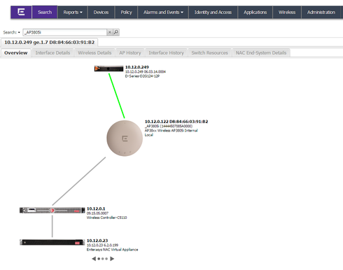

If you use NAC in your network you'd use OneView to see were everything is connected to.
In the example below I search for the AP name and I'd see the switch port, the home controller, NAC that was used to authenticate the AP.
