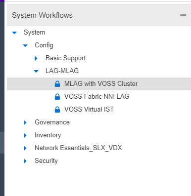

cslayton,
The default Workflows are changing with the upgrades.
Extreme is adding features and new workflows.
I can export it and send it to you by email if you send me your email address by private message.
Another option is to upgrade.

What version of XMC are you running?

Thanks all for your replies! I am new to XMC and completely missed the āworkflowā section. However, in my workflow tab I donāt see Configure ISC and MLAG Peers on EXOS. See screenshot. Iām wondering if this is a permissions issue.

another way could to enable āorchestration modeā before doing portconfig. Than the switch is doing a sync by themself.
