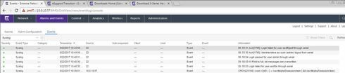

Our switches are sending syslog events to the netsight server.
In the file /var/log/syslog/ I can see, that the messages being received - but in the NetSight Console, I can't see the source-ip.
Without the IP it's hard to find the right events 🙂
Does anyone have ideas?
NetSight 7.0.6.27
EXOS 16.1.3.6
Summit X460

Anyway, I think I found your problem: The format of your syslog-target is wrong:
Format : DD-MM-YYYY HH:MM:SS TAG[pid]:
Maybe you should use a command like this:
configure log target syslog 10.58.36.210 format timestamp seconds date yyyy-mm-dd tag-id tag-name

Hi Chacko.
you point me to the right way.
I need to remove the "date" statement.
configure log target syslog 10.0.10.57:514 vr VR-Default local4 format timestamp seconds date none event-name none tag-id tag-nameNow the correct source is shown in netsight.
