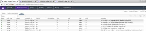

Format : DD-MM-YYYY HH:MM:SS TAG[pid]:
Port Type : UDP
5395015a002f4435b7113a9658904178_RackMultipart20170322-67602-syi2tg-NetSight_7_-_no_syslog_source_ip_for_xos_inline.jpg
EMS shows as source "22" !? instead of 10.0.10.55.
Whats wrong with my config?
thanks for your help.
