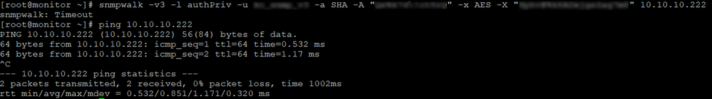

My AP121 isn’t working for SNMP GET queries. I have it configured for v3 (although I’ve also tried v2c and v1) via the ExtremeCloudIQ portal, and my AP122’s work perfect, but the AP121 doesn’t answer properly. I’m running the most current firmware (6.5.12), so I’m not sure why it’s not working.

Here is what I get if I PING and SNMPWALK the AP from the shell of my monitoring server.

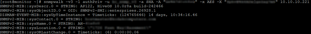

Here is the SNMPWALK for one of the AP122, using the same info.

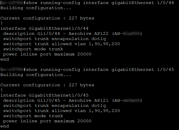

Here is the switch configuration for both APs

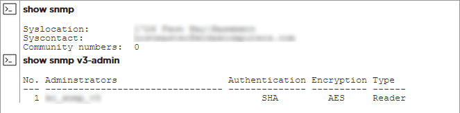

I can’t get a connection to the AP on udp/161. SNMP tools respond with “Timed Out”. The output from “show snmp” and “show snmp v3-admin” are in the screen shot below. This is the exact same SNMP settings (policy) that use on my AP122 devices and the output from them shows exactly the same, so the config seems to be right.

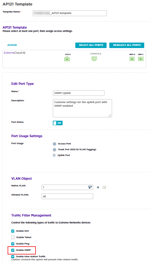

I’ve already double checked to make sure that Traffic Filters have SNMP enabled on the Wired interface.

What do you mean with “ the AP121 doesn’t answer properly”? Do you get no response? Or do you get wrong or missing information? What do you see when you enter “show snmp”-commands at the CLI?
