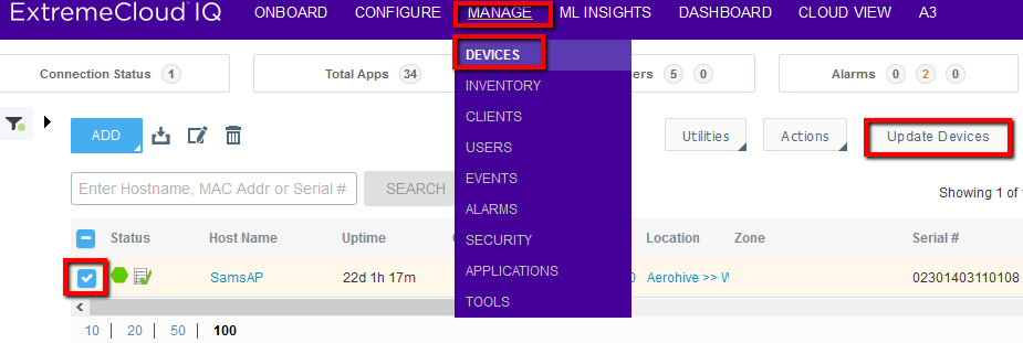

You'll need to go to Manage> Devices subtab. Then check the box next to the AP and click Update Device in the top right hand side of the page.
In the Device Update window that appears, check the box next to "Upgrade HiveOS and Extreme - Aerohive Switch Images". Then you'll want to look for the blue button that says "ADD/REMOVE".

Hi Sam,
I clicked the manage tab and selected all sub-tabs but could not find were to upgrade the firmware.
Thanks,
Joey
samantha_lynn
Esteemed Contributor III
I'm sorry, I'm using outdated terminology. You want the Manage tab, my apologies.
