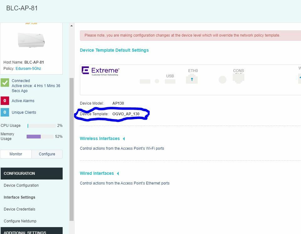

Does anyone know how i can Disable the option "Enable client transmission power control (802.11h)" on WiFi0 and WiFi1. I have tried to do this bij edeting the Device template that is used on the AP's and push it out in the Hivemanager using Complete Configuration Update After the Ap has rebooted the setting has not been changed. How can i do this for multiple ( about 400) Ap's at once?

Thank you for that data, at this point you're going to need a case so we can let our engineering team know that the template is not making it in to the running configuration or the generated configuration, which would explain why it's not getting applied.

So i need to log a case for this issue?
‎09-20-2019 09:02 PM
