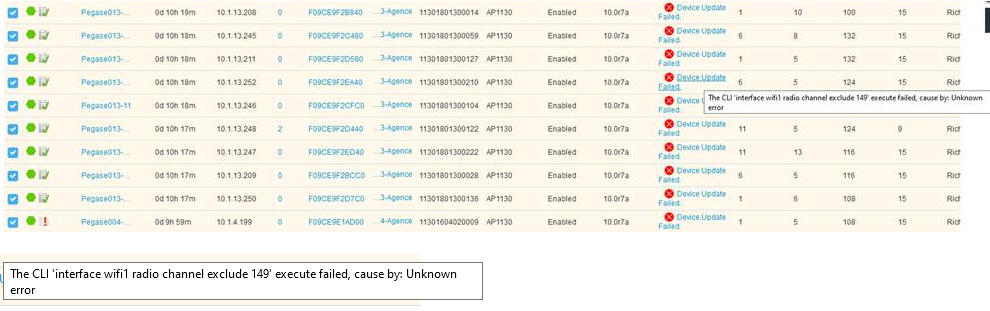

Hello, When I try to upgrade doing "Delta Configuration Update" we get a "Device Update Failed" While when I do "Complete Configuration Upadate" the update goes well. Would you know why the "Delta Configuration Update" doesn't work ?

The only issue you may run into is that not all devices (see your insights > devices > max client capabilities) support these channels (in particular 165). But from what I've seen the majority of clients do support this band. Clients would then connect on the 2.4GHz instead.
Just a note on the error, it looks like it may be a bug - Aerohive support are investigating and replicating.
