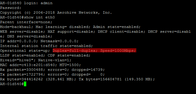

The ports on the AP will sense what the switch is offering and adjust to that accordingly. The switches are multigig capable, you would set this in the device template.
You can check what the AP is using by running the command "show int ethX" where X is the port number we're checking.
For example:
