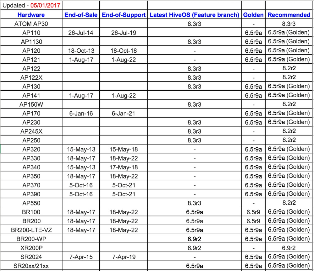

> It's not off-topic at all, in fact, I would strongly recommend upgrading Hivemanager Software to 8.2r1 before moving forward.
> I would then advise upgrading the HiveOS on each model of AP to it's 'Golden' or 'Feature' release. This matrix is accurate as of Today:
