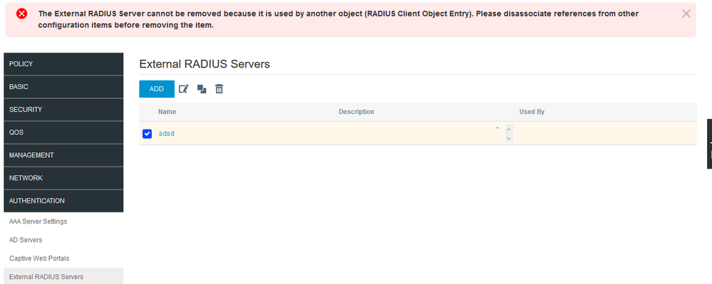

I tried to remove external radius server object from HM. But when i try to remove the object, it will give following error . "The External RADIUS Server cannot be removed because it is used by another object (RADIUS Client Object Entry). Please disassociate references from other configuration items before removing the item."
I don't find any RADIUS Client Object Entry in HM
Can any expert help me out here

‎10-23-2018 03:10 AM
Hi Sam,
Please do find the output as follow
‎10-22-2018 04:20 PM
Could you go to Configure> Common Objects> Under the "Authentication" section on the left hand side menu, choose "External RADIUS Servers", then find the object you are trying to delete and see what the "Used by" column tells us here?
