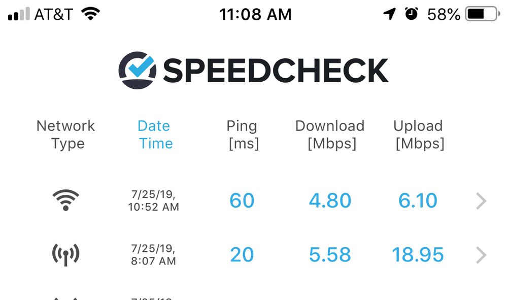

We noticed our download/upload speed has diminished quite a bit and was wondering if there was any changes made in the Aerohive platform that needed updates we missed?
pjbrake1
Last test was on our network while iphone was attached to our wifib93ba6d75cf649ec9cfe0042c4f23728_0690c000006khJzAAI.jpg

pjbrake1
Sam,
Thank you for your assistance. I have attached 2 Tech Data files from two of our hives. They have a few users, but since its summer there are not a lot of traffic, so there really shouldn’t be any reason our upload and download times are this slow. L
Cox 500 down and 30 up, so the tests are showing a big jump and it’s not good. L
