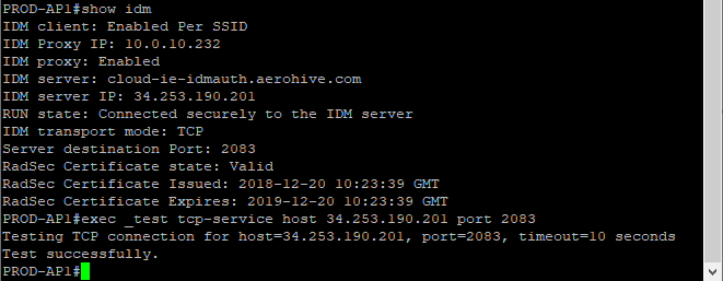

Hi Thomas, I've tested against the IDM server as below:

​Hello,
So I made a call with a Aerohive tech on the Captive Portal but without being able to solve the issue.
When I tried to test tcp port [TCP 2083, 20000 ~ 20256] on several of these addresses 34.253.190.192 ~ 34.253.190.255, I get nothing (unlike on tcp-80 and 443).
The addresses should answer to the TCP-port test ? Do you have test example ?
PS : My security team did confirm the port are open.
