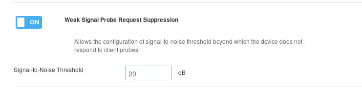

Hello everybody,
we have some trouble with sticky clients which does not roam to a better access point. Because of that i activated the option Weak Signal Probe Request Suppression for my 2,4 and 5 Ghz radio profiles.
After that i did a complete configuration update on all access points. Two days later i checked the connected clients for some access points and i found clients with really poor SNR values.
Weak-SNR-01 How is it possible? Is it correct that clients with a poor SNR still will be connected to an not optimal access point? Maybe i don't understand this option correctly.
We are using the on-premises Hivemanager NG (build version 19.5.1.7-NGVA ) and a lot of AP230 (HiveOS 10.0r5 build-228634 ).
Thank you in advance.

The most of the use the maximum of 20 dBm. Ok, i think i will try to reduce the transmit power by 1 dBm step by step. But i hope that the coverage is high enough at our campus. Thank you very much for your help.

While those are about as high as they can be set, what are the APs actually running at? You can add a column to your UI view to show their channels and the currently set power. Decreasing power is probably the simplest way to force clients to roam as if they cant hear the AP they're connected to in a given area, they'll surely roam to a stronger AP.
