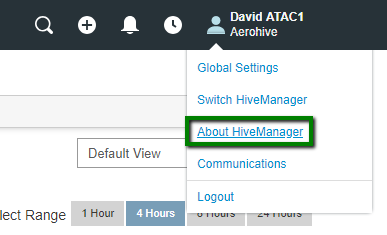

First, go to About Hivemanager
Then Firewall Guidelines
