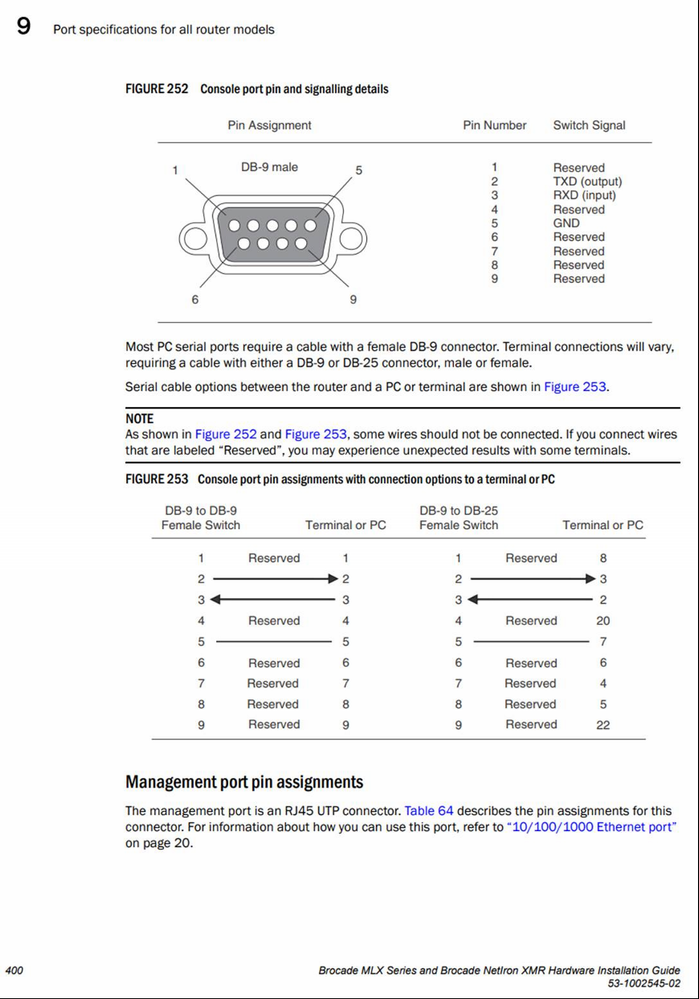

Do you have this seen on both Management console ports?
Can you doublecheck the Serial Cable as shown above
