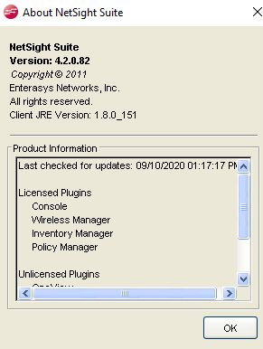

Well, this is even older than your switch firmware. 🙂 (current Version is NetSight 8.5)
Is this the only switch that has this problem? Are others working fine? Do they maybe have another firmware?
If I understand it correctly, this problem only occurs sometimes and is not always the case?
