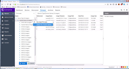

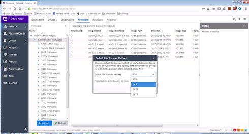

Dave_Hammers
under XMC control in the Firmware panel.
You can designate a transfer protocol for device families, or individual device types.
